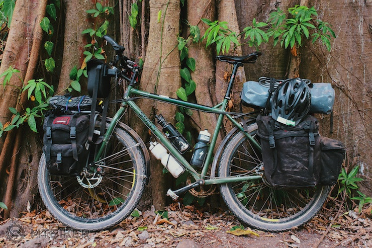

napr.
https://surlybikes.com/bikes/troll
https://www.google.com/search?client=firefox-b&biw=1920&bih=938&tbm=isch&sa=1&ei=pXn9W8GIMo7cwALQyb_IAQ&q=touring+bicycle&oq=touring+bi&gs_l=img.3.1.0i19l10.1414.2075..4440...0.0..0.267.575.0j2j1......1....1..gws-wiz-img.EeGV5IO1FTM
Da sa take daco aj realne kupit v nejakom kamennom obchode na Slovensku? Vyzera to skor ako skladacka.
