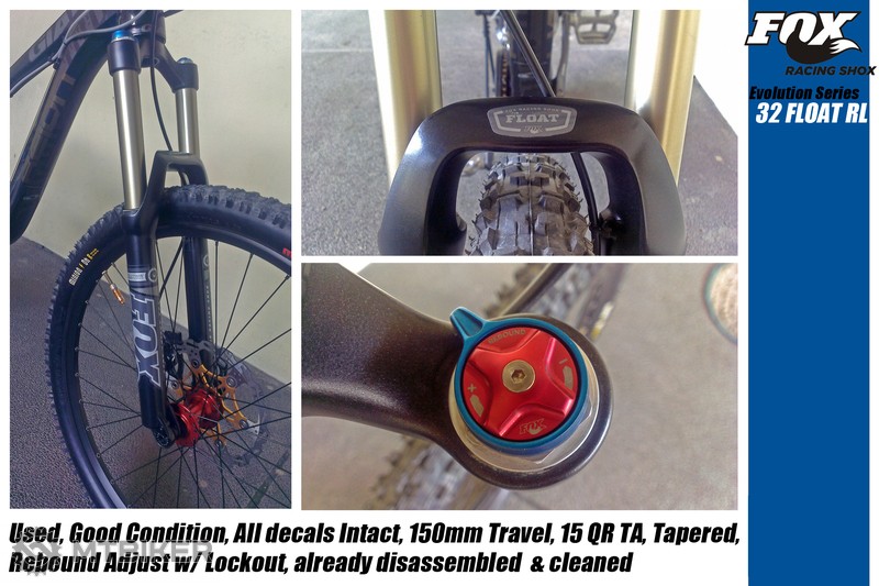

Nazdar. Viete mi niekto poradit so sa mi oplati viac?? FOX 32 FLOAT RL 150mm QR 15 model 2012 alebo RockShox Revelation Solo air 150mm QR15 model 2013 ? Dik
