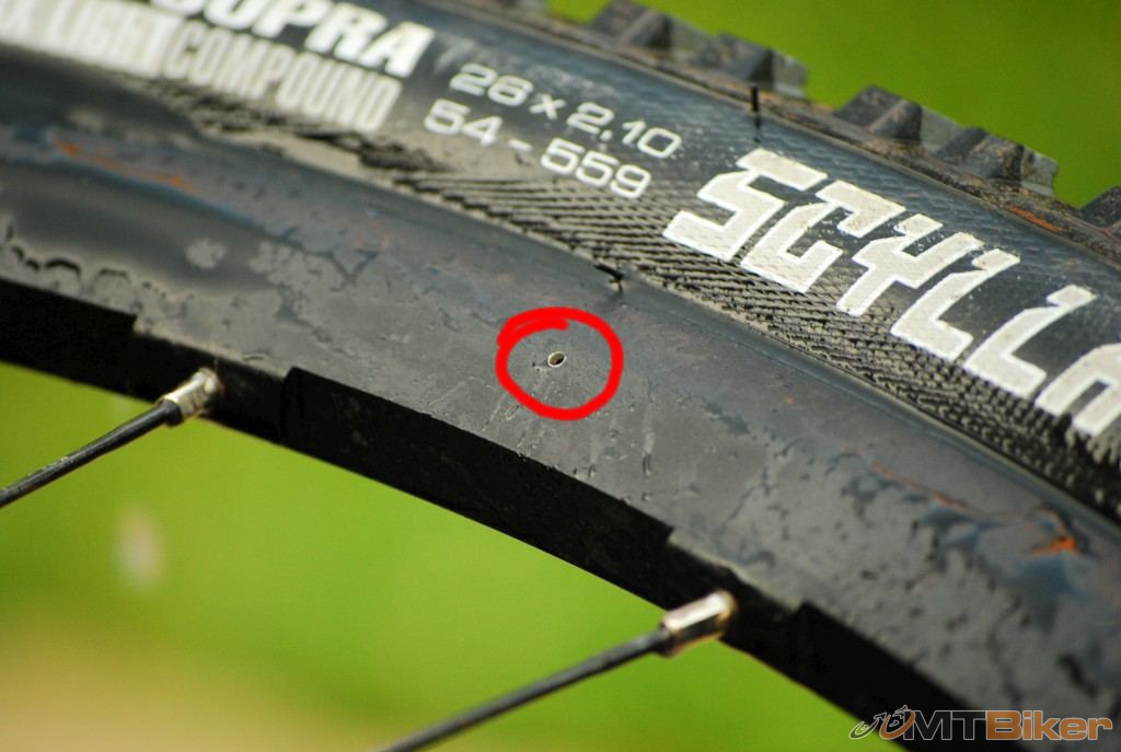

Ku kolám Fulcrum som mal takýto magnet. Nejako som nepochopil ako ho môžem použiť, či k nemu existuje nejaký adaptér, alebo sa dá "namontovať" na špice nejako inak?

Ja by som tipol ze na odvodnenie resp. odparovanie nahromadenej vlhkosti. Ale kto vie... Popri niploch sa dovnutra voda vzdy dostane a potom nie a nie von a postupne zacina korozia. Kedze Fulcrumy nemaju vrtanie z vnutornej strany, tak tento otvor mi pride ako jedina moznost.
Reading the various comments about a buzzing noise coming from near the spoke’s on the Fulcrum Racing 1 wheelset, I too encountered this problem on two sets of wheels both front and back – first set was exchanged under warranty, turns out it’s to do with the way the rim is assembled and is a known problem in the bike trade, small shims used in manufacture work lose and cause the buzzing noise, my bike shop drilled a small hole into the inside of the rim and removed the offending item, this has stopped the buzz and does not either compromise the strength or safety of the wheel.
Authorised Fulcrum dealers should know about this fix.

ale nie... suhlasim s jokom. mozno este vyrobna vada?
