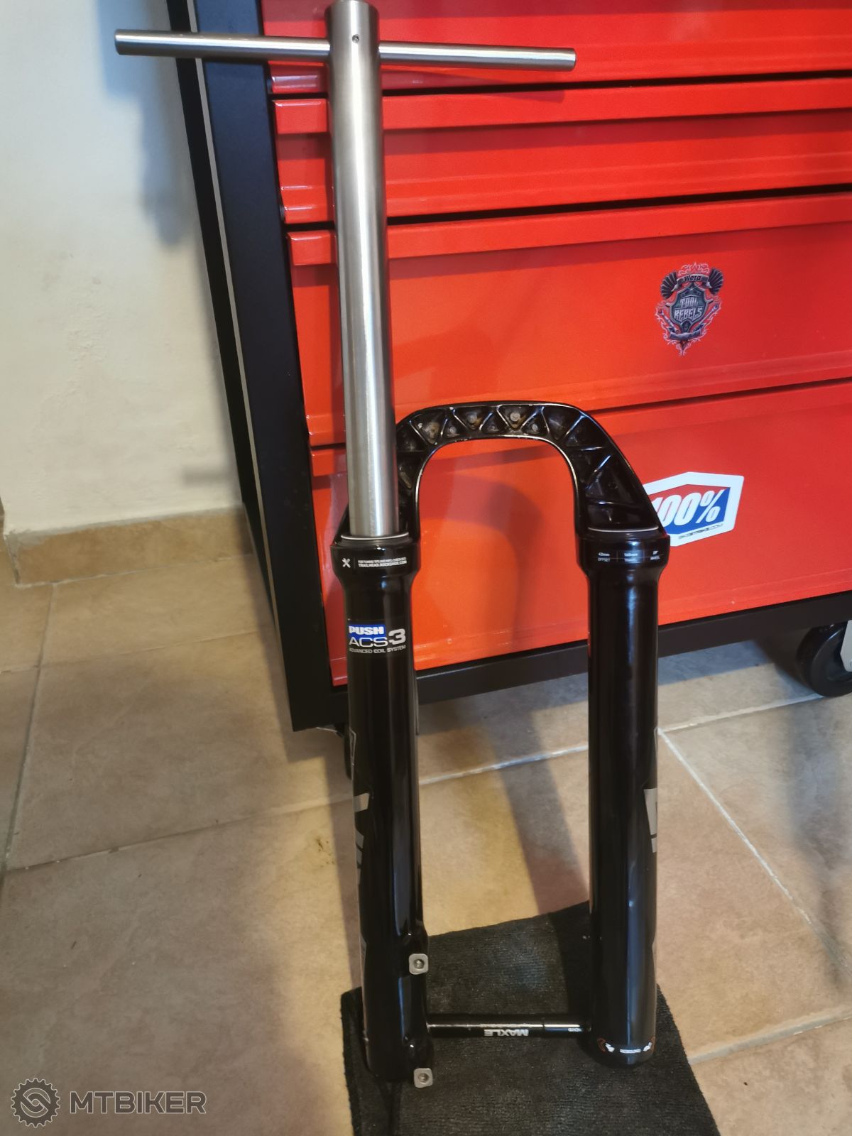

MOC 40,99 €"When we resize bushings we actually force them slightly oversized. We offer two sizes (custom sizes available on request) – xx.07 and xx.10. In this example I am working on a Fox 36 fork so the sizes I would need are 36.07 and 36.10....Once we have pushed the xx.07 tool through it’s a good idea to preform another test with the uppers. Some forks benefit from having the next size up pushed through while some don’t need it. If your forks are still a little tight then repeat with the xx.10 head"
Najprv som skusil nahodit spodne nohy na horne pred burnishingom. Islo to dost tazko, ale povedal by som, ze pekne hladko. Potom som to iste skusil po a bolo to o trosilinku lepsie. Ziaden velky rozdiel. Je ale pravda, ze som to skusal s novymi nahodenymi guferami. Tak aj tie pridavaju urcite nejaky odpor.
Takze dalsia faza je vyrobit dalsiu havicku na rozmer 35.10
