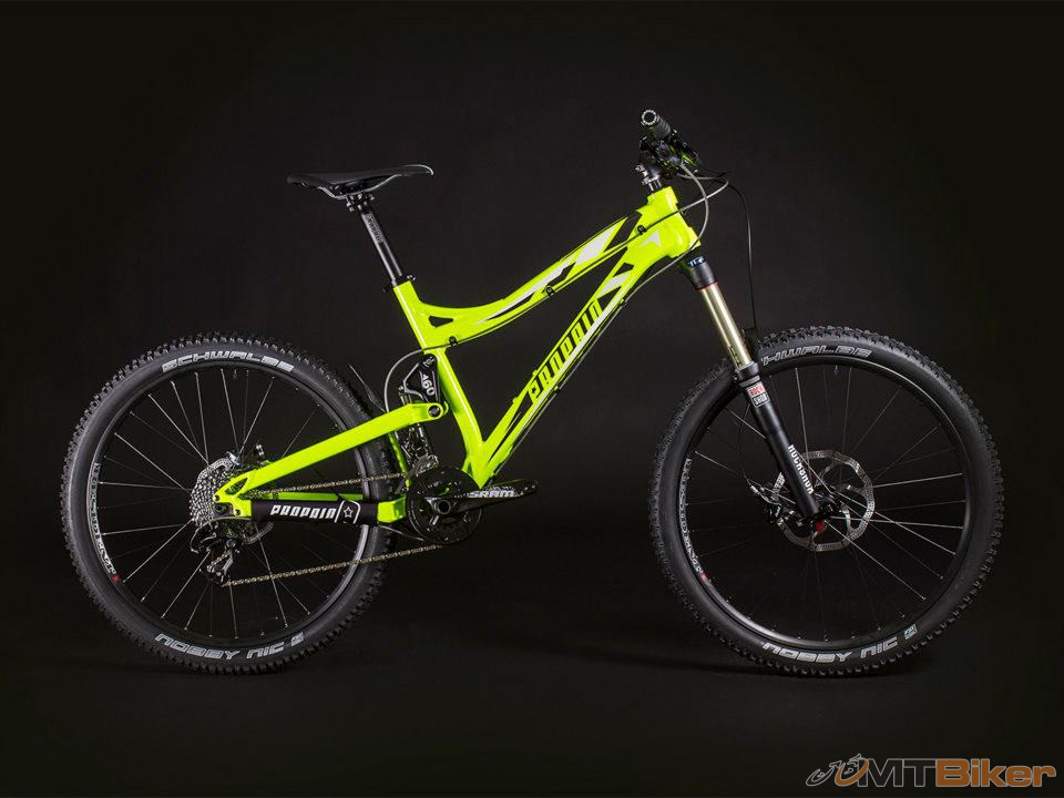

K Propain TYEE 1 - co hovorite na setup? Tlmenie(Lyrik RC,Monarch R HV),kolesa,zadna stavba..?
V com je zly uhol 75,2 sedlovej trubky?
Co hovorite na wheelset Sun Ringle Charger(Canyon Strive), Sun Ringle Demon-inferno (Radon Slide)?
