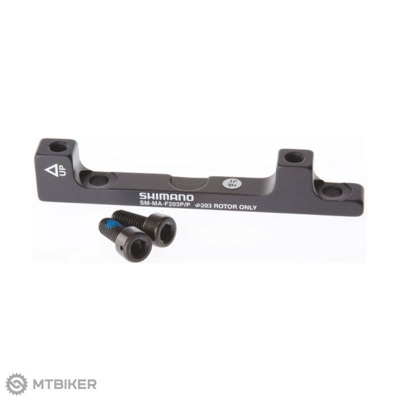

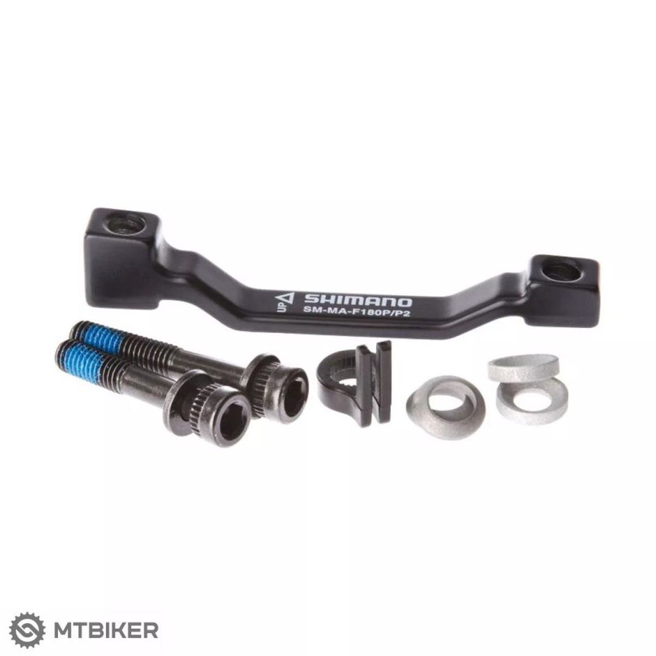

SM-MA-F180P/P2
140 mm fork mount - for using a 160 mm brake disc
160 mm fork mount - for using a 180 mm brake disc
140 mm frame mount - for using a 160 mm brake disc
160 mm frame mount - for using a 180 mm brake disc

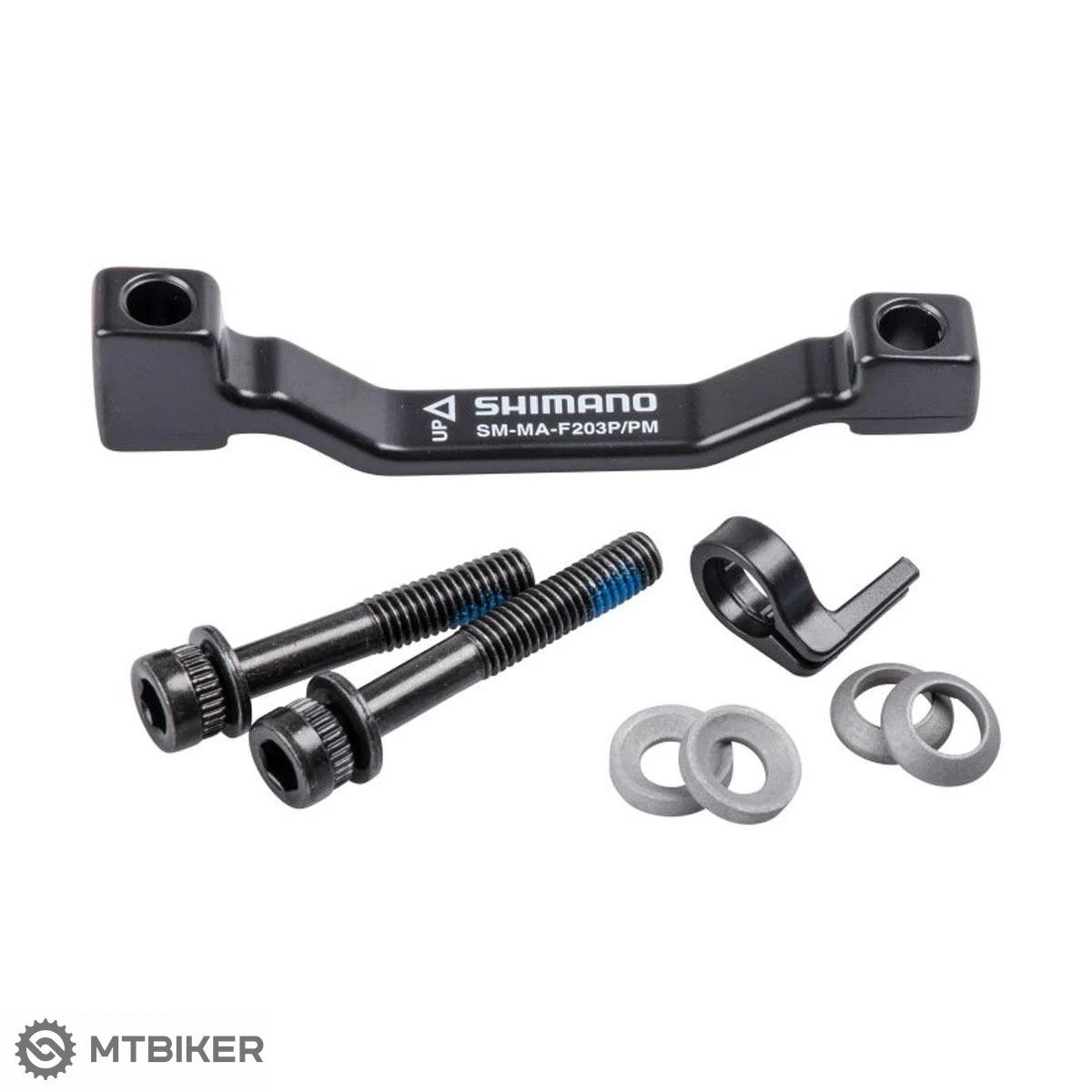

SM-MA-F203P/PA
160 mm frame mount - for using a 203 mm brake disc
https://www.mtbiker.sk/shop/komponenty/brzdy/diely-a-adaptery/shimano-post-mount-sm-ma-adapter-predny-zadny-pre-kotuc-180-mm-p107591.html?itm_medium=widget&itm_campaign=
na 203 mm treba tento:
https://www.mtbiker.sk/shop/komponenty/brzdy/diely-a-adaptery/shimano-adapter-predny-zadny-post-mount-pre-203-mm-kotuc-p532.html?itm_medium=widget&itm_campaign=
Ak má vidlica úchyt taký,že bez adaptéra je namotovaný 180 mm kotúč,tak na 203 mm treba tento:
https://www.mtbiker.sk/shop/komponenty/brzdy/diely-a-adaptery/shimano-adapter-na-predny-zadny-kotuc-zo-180-na-203-mm-post-mount-p103049.html?itm_medium=widget&itm_campaign=
neni zač
