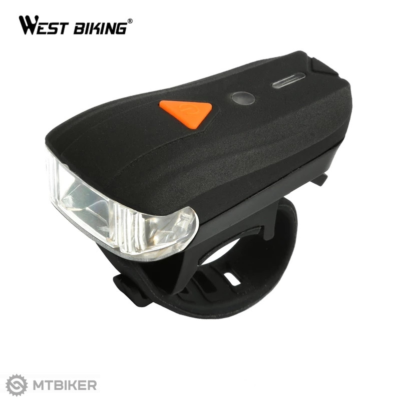

pripadne silnejsie https://pro-body.sk/eshop/prod_detail.php?id=1007299
http://s.aliexpress.com/UnuYvIFf
http://s.aliexpress.com/MrUFfa6N
Obe nabíjacie cez USB.
