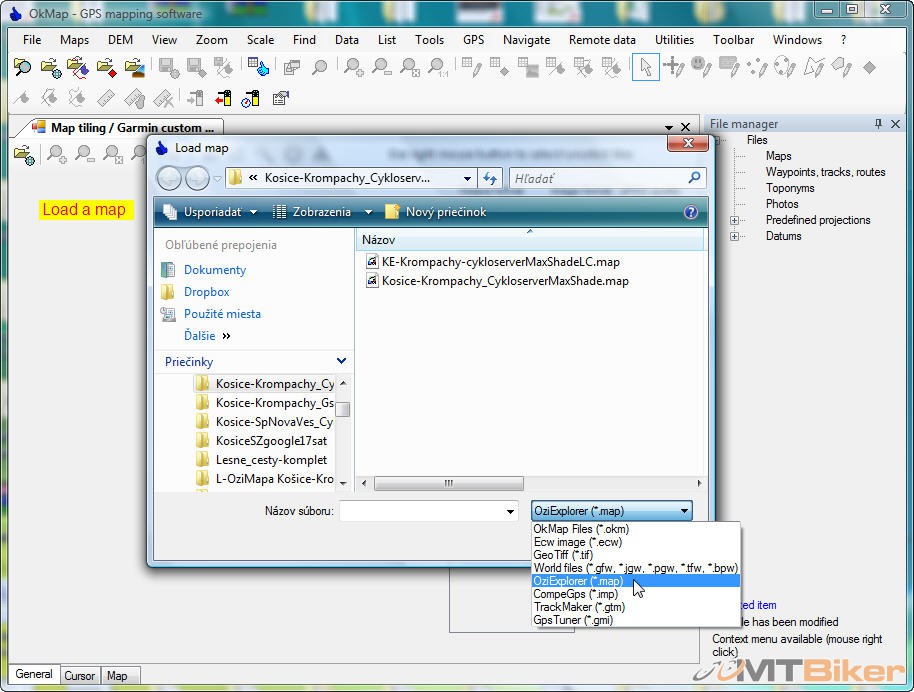

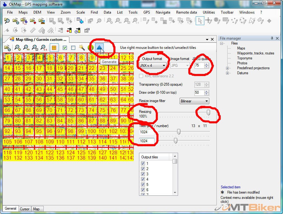

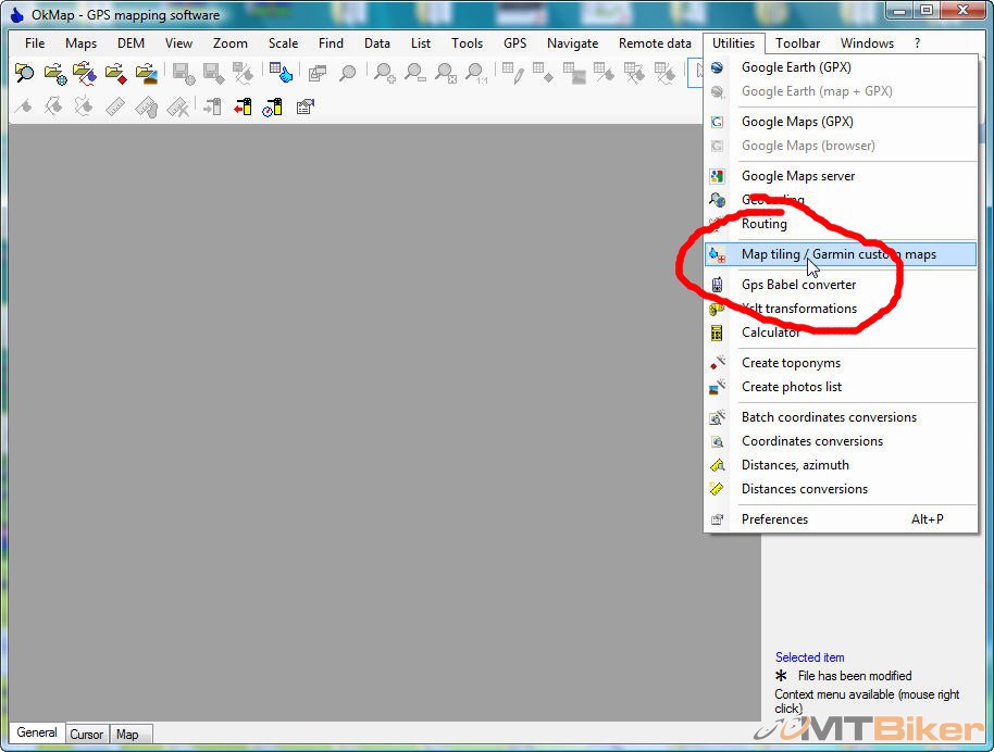

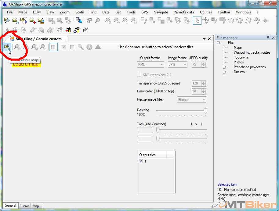

OkMap freeware GPS software
OkMap je ďalšou možnosťou, ako si napr. z mapy pre OziExplorer vyrobiť JNX mapu. Postup je zrejmý z obrázkov v prílohe.

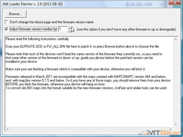

Najnovší FirmwarePatcher2.9 je možné použiť pre všetky navigácie Garmin podporujúce JNX formát máp (Birdseye), to znamená aj model Montana a tiež aj nové eTrexy.
Posledné verzie FirmwarePatchera majú pridanú zaujímavú voľbu: "Adjust firmware version by number ...". Použijeme ju vtedy, keď v navigácii máme poslednú nepatchnutú verziu firmware a chceme ju nahradiť tou istou verziou, ale patchnutou. Za normálnych okolností by totiž upgrade na tú istú verziu v navigácii vôbec neprebehol, navigácia by súbor gupdate.gcd tej istej verzie ignorovala. Doteraz sme museli najprv vykonať downgrade.

Version 2.13, 2012-10-13:
[+] Support of Alpha 100 firmwares is added.
[+] Support of firmware version 2.87 for Etrex 20/30 added.
Version 2.12, 2012-09-22:
[+] Support of firmware versions 4.50 for GPSMAP 62/78, 3.30 for GPSMAP 62 sc/stc,
4.60 for Montana, and 6.00 for Oregon x50 is added.
Version 2.11, 2012-05-08:
[+] Support of firmware 3.50 for Colorado Taiwan edition added.
Version 2.10, 2012-05-05:
[+] Support of firmware versions 4.02 for Montana is added.
[+] Support of firmware 2.50 for Edge 800 Japanese edition added.
[+] GCD parsing improved.
Version 2.9b, 2011-12-11:
[+] Donation reminder dialog added.
[-] Outdated link to the homepage is fixed.
Version 2.9, 2011-09-30:
[+] Support of Etrex 20/30 firmwares is added.
[+] Added "Adjust version number" option, which can be used to flash the same
version of the firmware as currently installed in the device.
