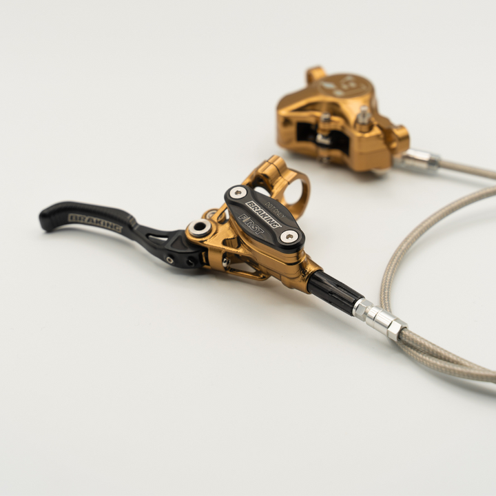

www.braking.com
https://www.braking.com/en/collections/bike-mtb-e-bike/products/f-i-r-s-t
kto chce byt first na fore? :D
