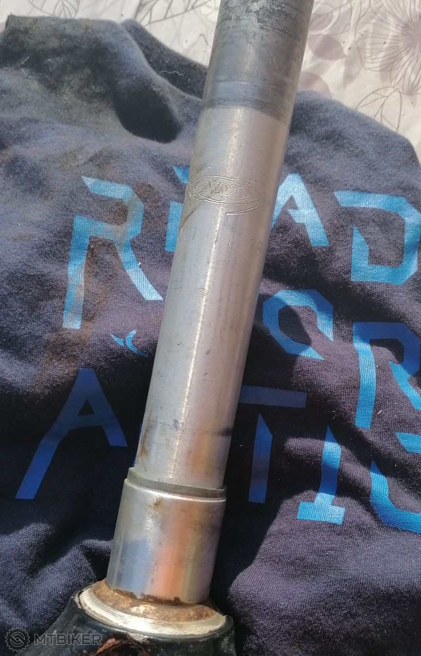

po malej demolacii so nuteny vymenit vidlu bike je giant tcx, lenze ked son tu zlomeninu demontoval, tak som zistil, ze ma cudny rozmer (asi nejaka giant vychytavka) horna cast je klasika, ale dolu je to cca 33mm
co s tym?

co s tym?
Fork Alloy, OverDrive Steerer w/ Eyelets
https://www.giant-bicycles.com/int/technology/detail/50
Podla tohoto je to vymenitelne za klasicky vidlu: https://forums.mtbr.com/shocks-suspension/giant-overdrive-fork-confusion-1002507.html
