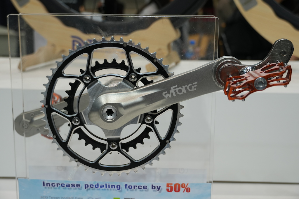

Snaha o zvýšenie efektivity šliapania
https://www.pinkbike.com/news/final-randoms-taipei-cycle-show-2025.html
ep1.pinkbike.org
