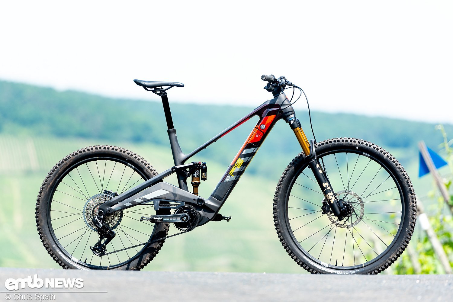

Rotwild s Avinoxom s vlastnou, vyberateľnou 864Wh baterkou. Olympia tiež predstaví bajk(y) s Avinoxom.
https://www.emtb-news.de/news/neues-rotwild-r-ex-2025-mit-dji-im-ersten-test-highend-meets-high-power/

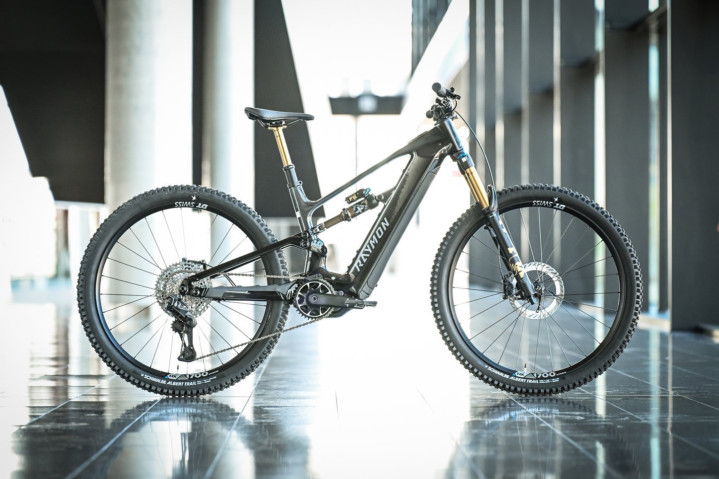

zobudila sa konečne aj Yamaha, PW-X4 motor, 48V, 100Nm, 800W peak, 843Wh baterka, top tube displej, mobilná aplikácia
https://ebike-mtb.com/en/new-yamaha-pw-link-motor-system-at-a-glance/
Raymon Ravor s PW-X4 motorom
https://www.emtb-news.de/news/eurobike-2025-raymon-ravor-yamaha-pw-x4/
