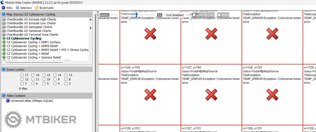

https://www.mtbiker.sk/forum/cyklotrasy-navigacie/sasplanet-a-mobac-dva-programy-na-jednoduchu-vyrobu-map-t24405.html
