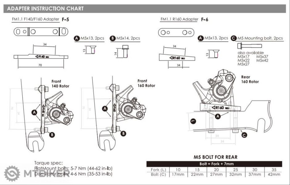

https://www.google.com/search?q=flat+mount+post+mount+adapter&client=ms-android-samsung-gs-rev1&prmd=isvn&sxsrf=ACYBGNS1R10ZZSXY4-2YEQn-JHu_QzEDnA:1576224906281&source=lnms&tbm=isch&sa=X&ved=2ahUKEwjp3f-sl7LmAhXQEcAKHZPlCUUQ_AUoAXoECA0QAQ&biw=360&bih=612

https://www.assolutions.ca/shop/adapters/flat-mount-brake-caliper-to-160-post-mount-frame-fork-with-160-rotor/
Mrte drahé. Ja som vyrobil doma

https://www.bike-discount.de/en/buy/shimano-adapter-postmount-hr-auf-flat-mount-160mm-sm-ma-r160pdh-679886

Presne tak, a vidim ze sa to asi neoplati. Len ma zaujala cenovka mechanickych strmenov tektro na bike-discount, ktore by sli na mestsky bike.
Mchmm, otvoril som si taketo nieco https://forums.mtbr.com/brake-time/hope-brake-adapters-explanation-1048820.html a teda pekny gulas to je
A prec nie adapter od Shimana ?
