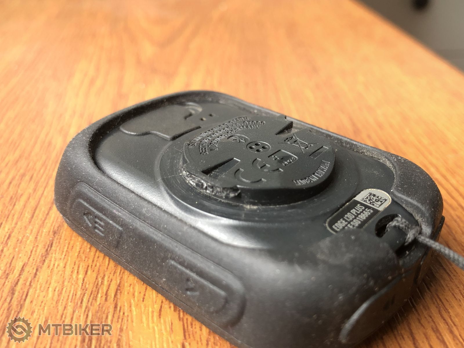

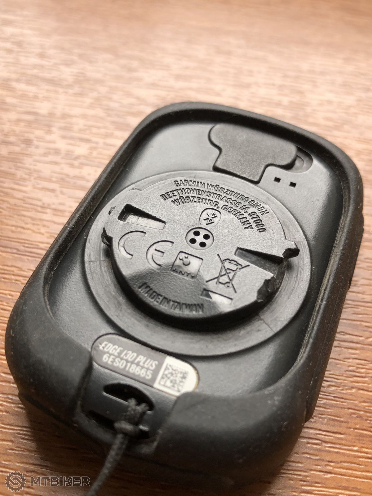

nejaky napad co s tym, pls?
https://www.joom.com/sk/products/681b3ddeaea52d010d80f3a4?variant_id=681b3ddeaea52d1a0d80f3a7
https://mountainsports-distribution.com/products/dogears-replacement-plate
https://framesandgear.com/products/framesandgear-garmin-edge-replacement-mount
Ako sa ti to stalo?
