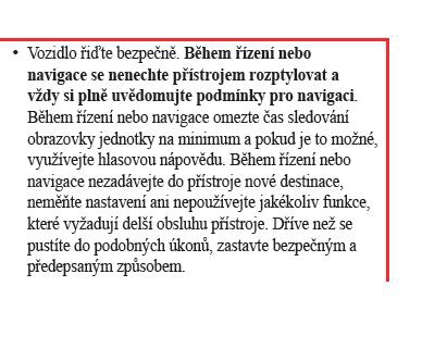

http://www8.garmin.com/manuals/2371_ImportantProductandSafetyInformation_Multilingual_.pdf
Jasne, ex post som si to uvedomil. Je to sto pro my fault...
