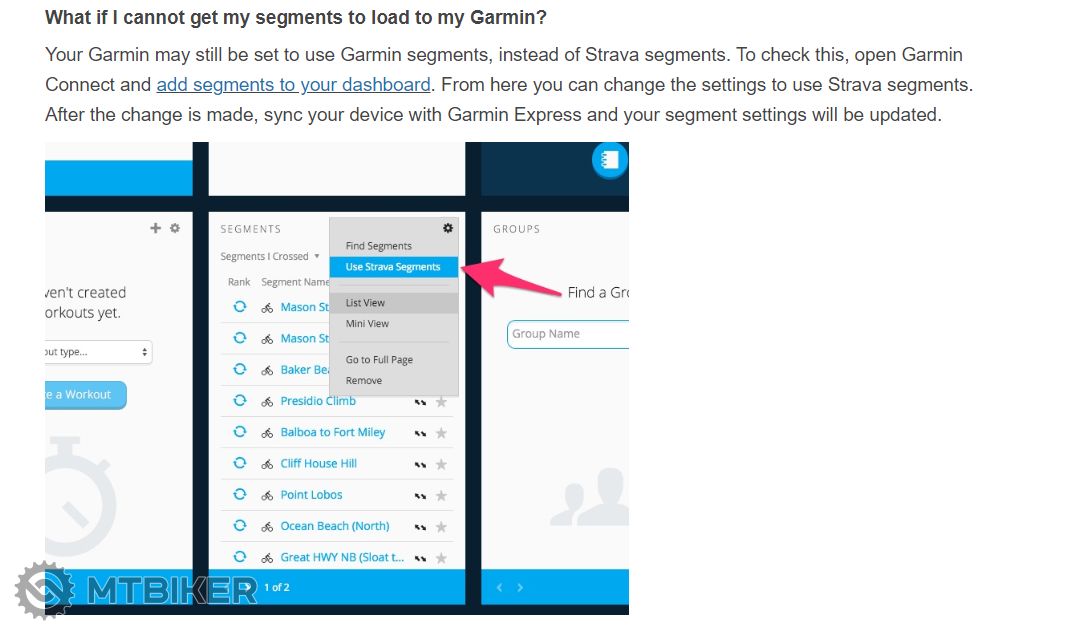

V Garmin connect chod do segmentov a tu si to mozes zapnut. Synchronizovane su tie co mas oznacene hviezdickou ako oblubene.

- When you use the navigate function to follow a course, Strava segments do not work. Only Garmin Segments work in parallel to navigation. Strave segments work when navigation is off. They also work if you start a track with the Strava IQ App on the Edge.
- Strava segments will work when following a course provided that the course was created on Strava and loaded to the Edge using the Strava Route app.
