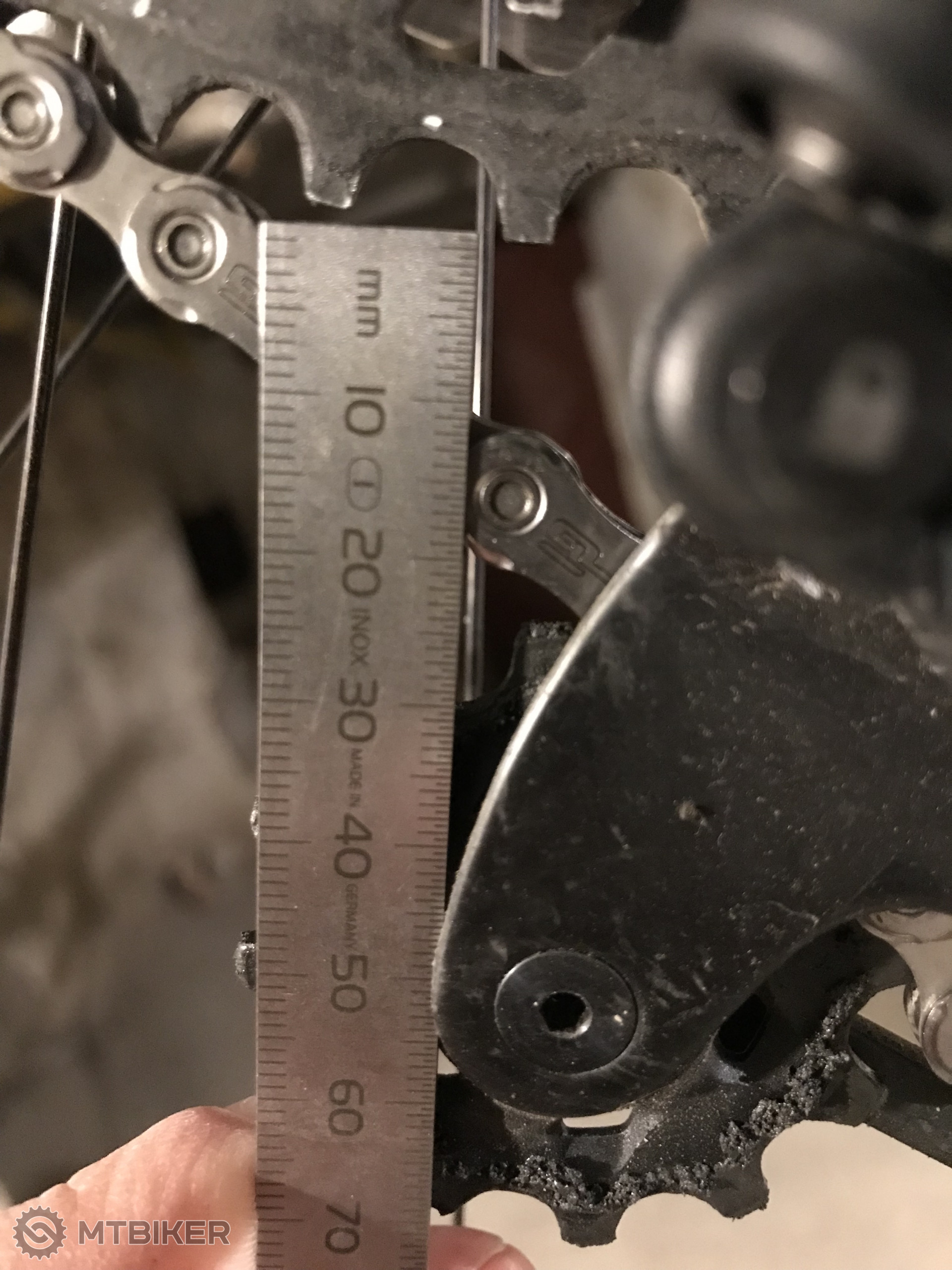

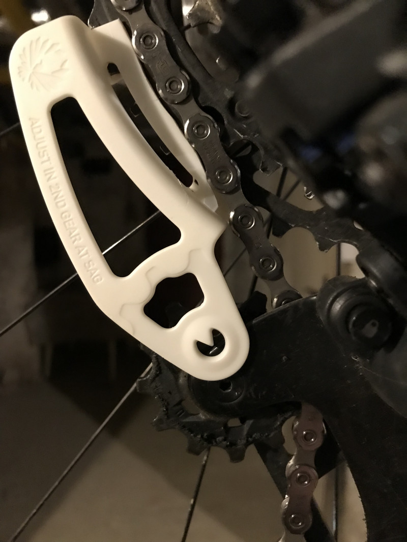

1. Od zuba 51 pastorku vs. stred kladky - 52mm
2. Od zuba po zub na velkom pastorku - medzera - 25mm
3. Od zuba 10 pastorku vs. stred kladky - 52mm
4. Sirka retaz 12s KMC - 5.38mm
5. Sirka retaze 12s Shimano - 5.28mm
6. Prezany pre Shimano kazetu biely pripravok na b gap - je uplne mimo

14.02.2022 - 19:45:38
A ta moja KMC ebajkova ma 5.35mm v strede a 5.58mm na nitoch, tam moze byt problem. Cakam na XT retaz.
