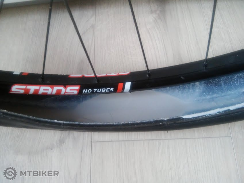

Plášť - Maxxis Ikon 3C Max speed EXO TR
Mlieko - Stants no tubes
