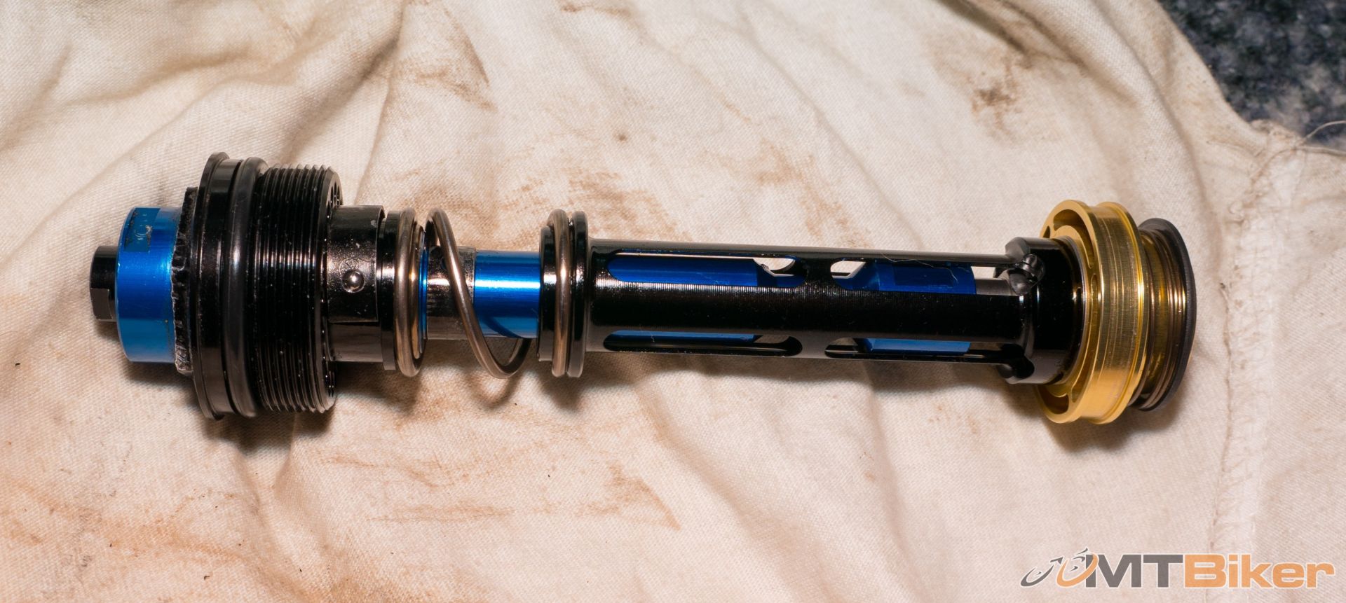

Next you are going to want to grip the threaded part of the top cap and the gold piston at the bottom, then turn the piston to the left (left from looking at the bottom of the Mission Control Damper) which will unscrew it.
Snazil som sa zvysit progresivitu vidlice tym, ze som v kompresii vymenil dve 0,1mm podlozky za tri 0,15mm. Tak som zvedavy co to povie v terene. Ked bude treba pridat, tak pridam, len nech to nebacha dorazy.
Po troch dnoch patrania som ich vytiahol z tlmica Xfusion O2 RL. Je ich tam pokkt teda. Vybere si kazdy. Takze som ho vlastne obetoval ale kakat nan. Nestoji za nic aj tak.
