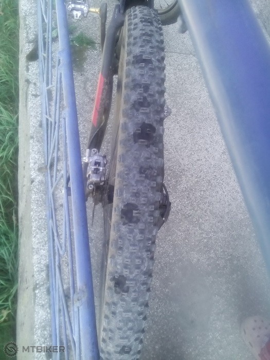

Kristina keby si videla moje
http://www.mtbiker.sk/forum/post1095887.html#p1095887
