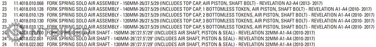

+ ze vzduch unikol priamo z komory bolo citit aj na chode packy lockoutu - bez tlaku, resp s nizkym, sa pretaca velmi volne, kedze tam nie je ziadna protisila voci ktorej to tlaci pri prepinani rezimu
Vďaka
https://trailhead.rockshox.com/en/specs/22T43931114
https://www.sram.com/globalassets/document-hierarchy/spare-parts/spare-parts-catalog/2023-rockshox-spare-parts-catalog.pdf
