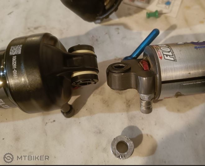

Mozno este skusit rwc, ihlickove loziska, tie vyrabaju aj v 15,75mm sirke: https://www.realworldcycling.com/products/rear-suspension/shock-eyelet-bearing-kits/6mm-8mm-thru-bolts/NBKRWC1575.html?ucacid=1364842879.364446
A ak pouzit povodne Fox riesenie, tak urcite radsej s polymerovym puzdrom.
Takze vahadlo kludne, do ramu bud ten RS, alebo mozes skusit tie uzsie, alebo proste zbrusit kusok.
